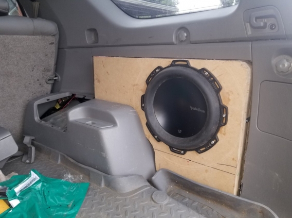

Next I built a layered MDF subwoofer box for a Rockford Fosgate T1 10 inch.  The whole system is ran off of a Rockford Fosgate Power T1000x5ad 5 channel amplifier.
The system sounds amazing, the subwoofer is such an improvement over the stock system.  It's just incredible this little 10 can do what it does.

The start of the box
