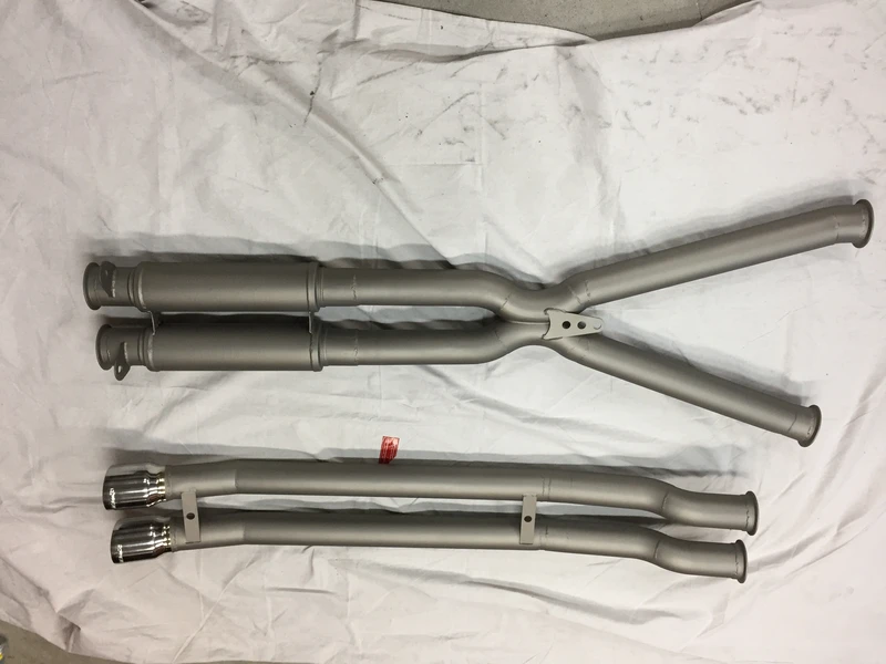

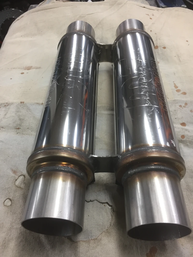

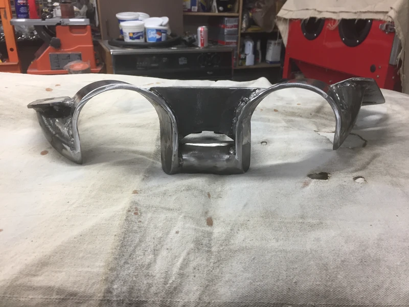

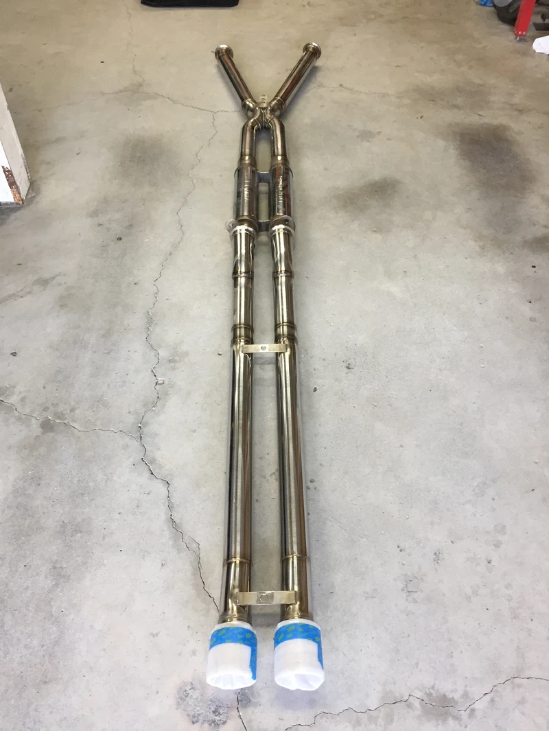

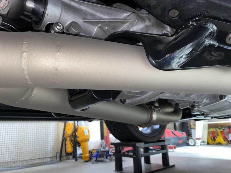

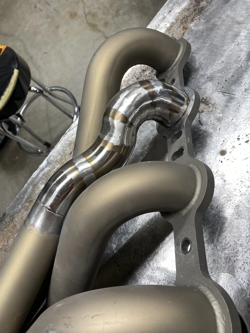

To begin with, this system was built specifically for this car, LS swap, and suspension. A custom transmission cross member had to be fabricated in order to fit dual 3” pipes. The headers are Speedway stainless steel 3rd gen LS swap units with the #3 tube modified for the R&P steering shaft. An X-pipe and two 18” X 5” MagnaFlow “mufflers” were added to complete the system. I TIG welded the entire system in my shop and it has a titanium ceramic coat with polished tips. I have added a third muffler to the system in the hopes that it will quite this beast down a bit. It made a noticeable difference, probably 10-15 db and less raspy, but still a nice rumble.
