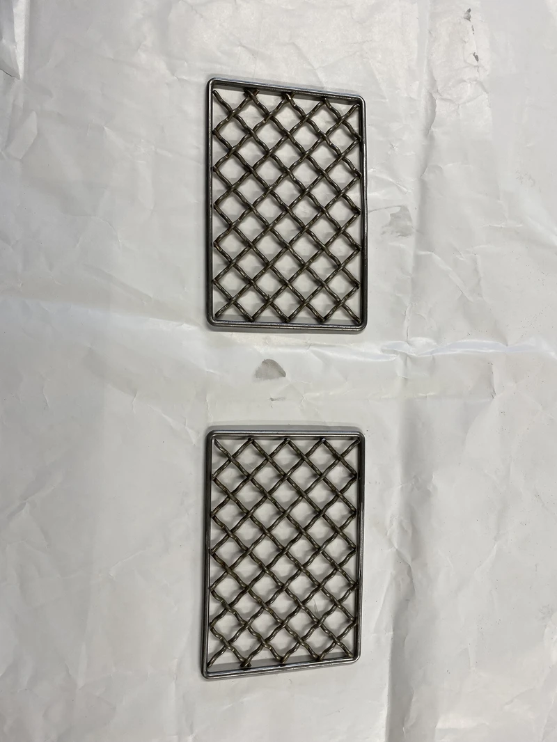

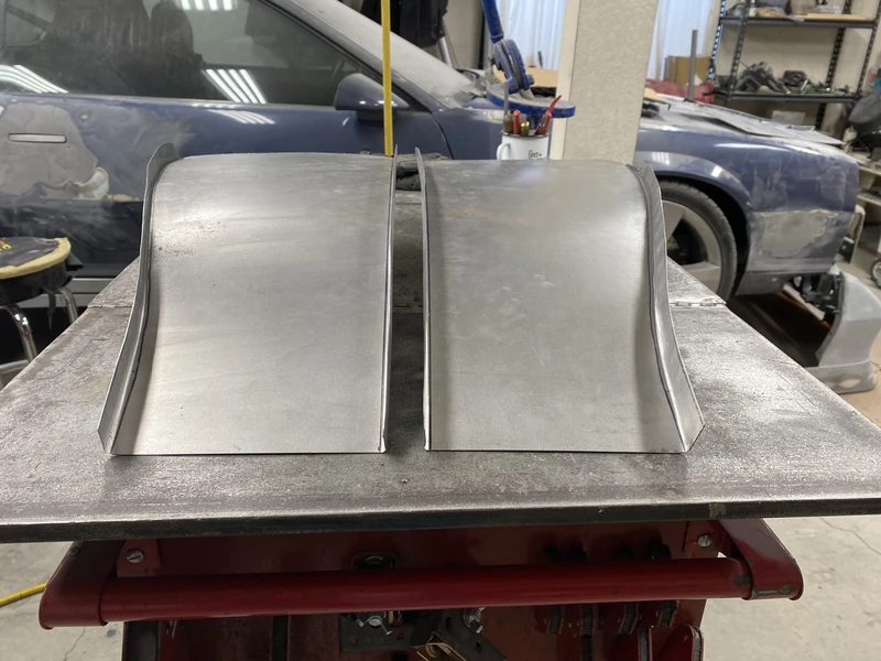

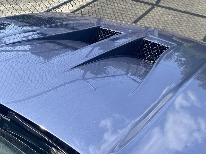

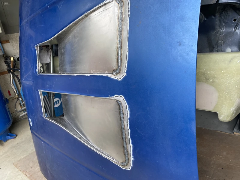

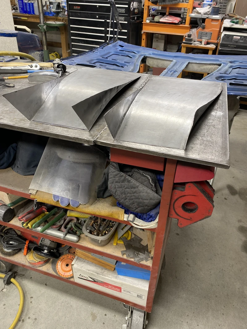

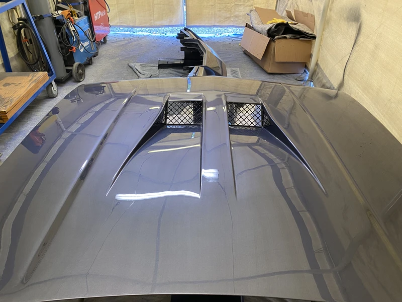

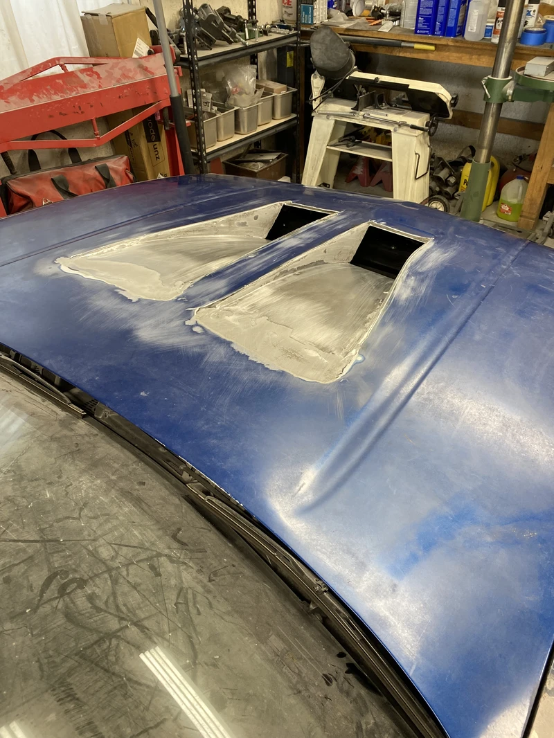

I modified an IROC hood from the recycle yard to make a one of a kind extractor hood. The center sections were cut out and new hand formed pans were made from 20ga sheet metal, TIG welded, bodyworked, and painted. Custom grills were made from stainless steel wire grate to match the front grill. The ducts are aligned with the cooling fans on the radiator.
