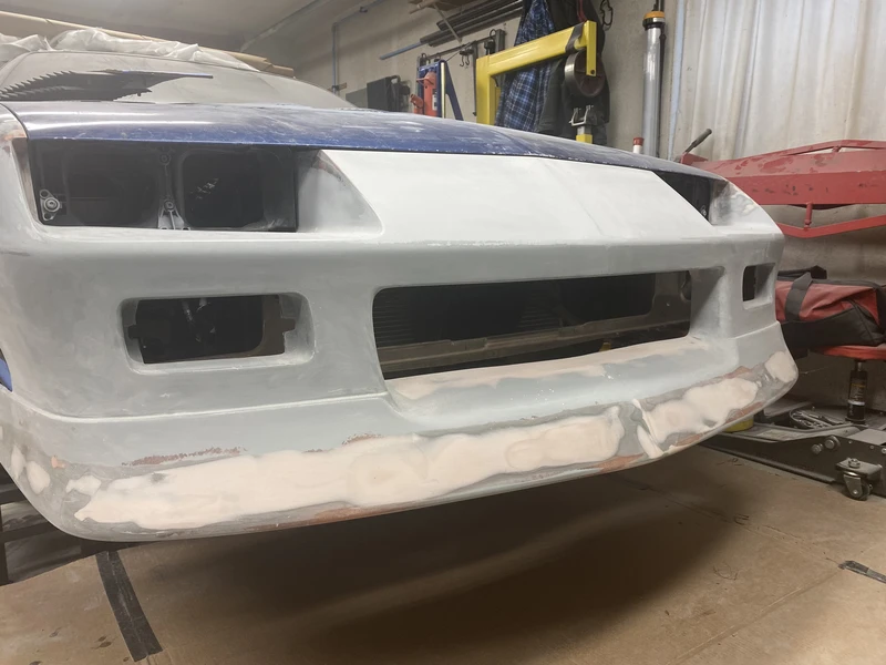

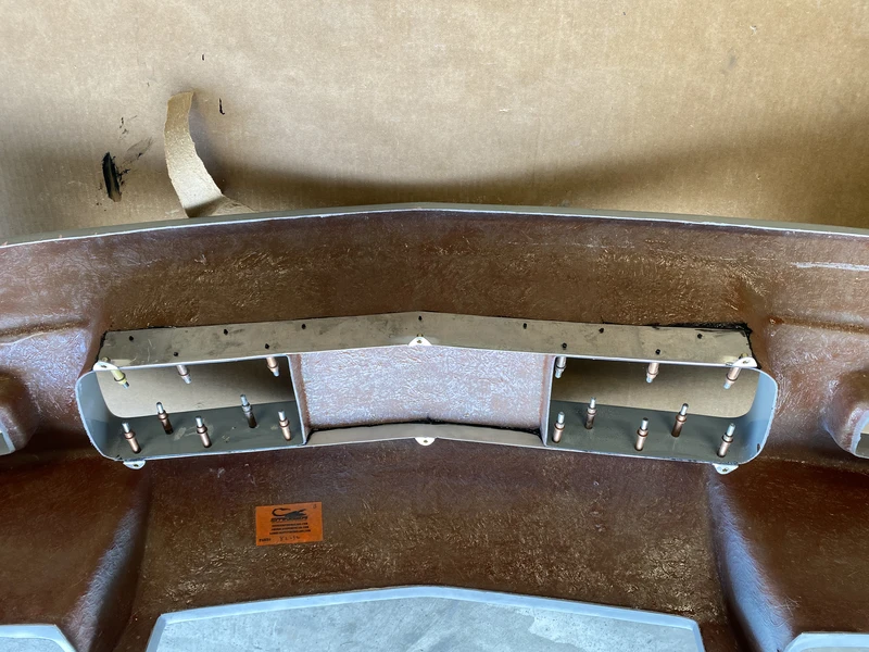

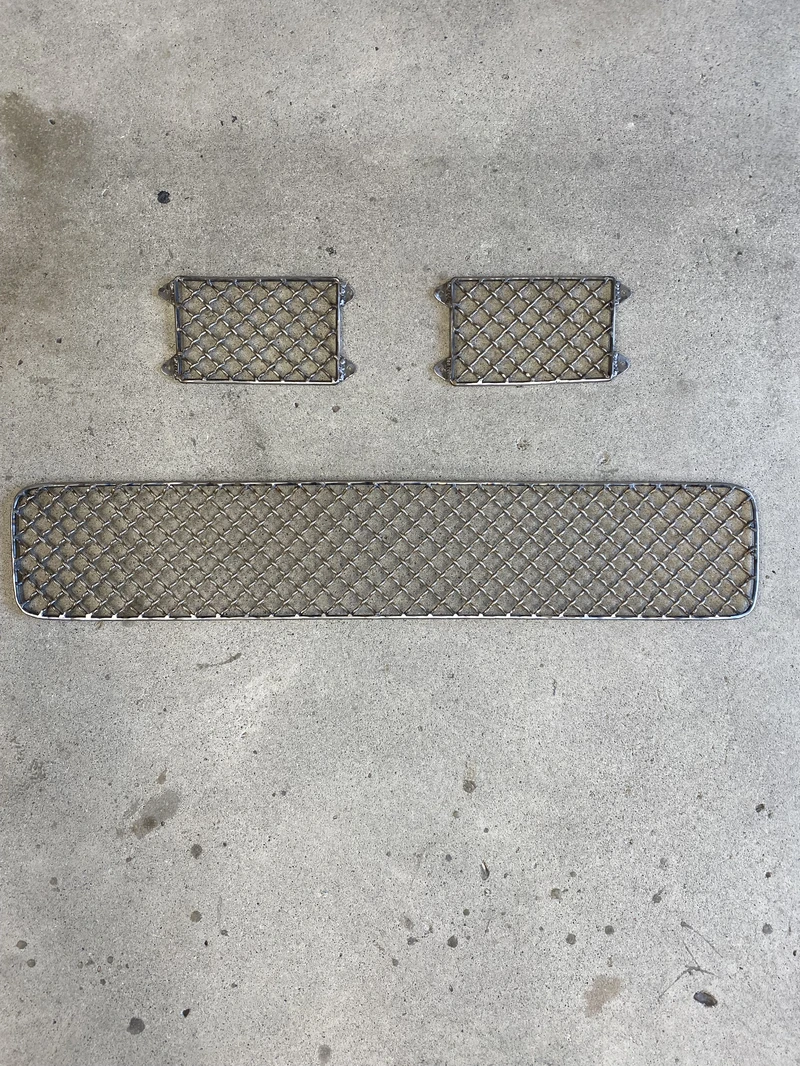

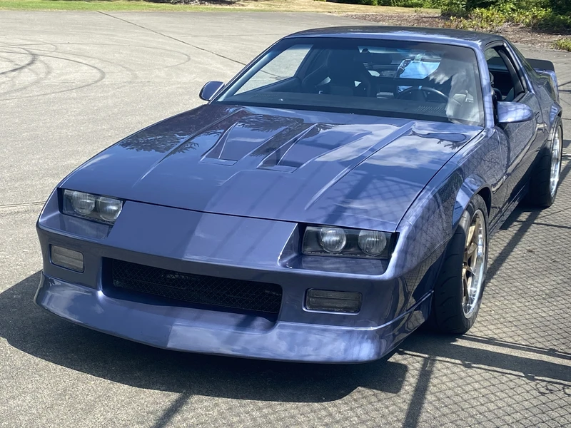

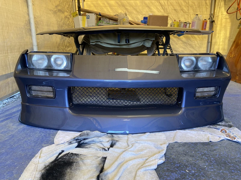

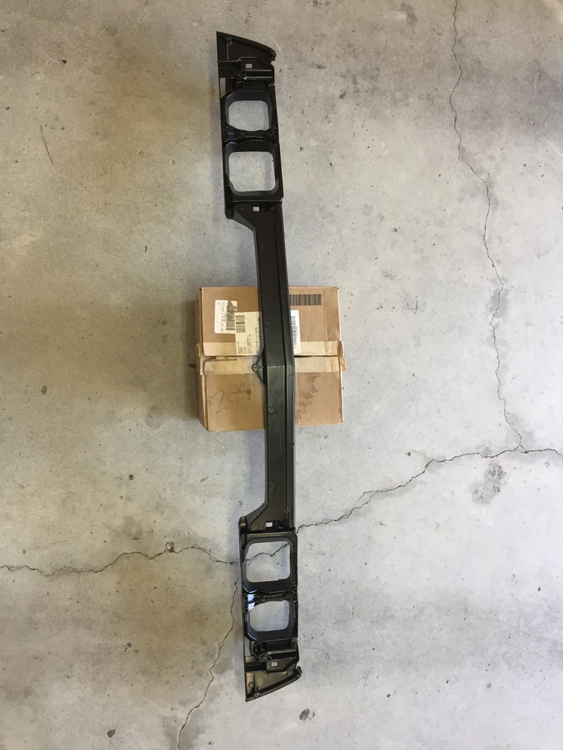

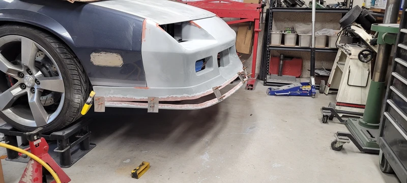

I bought a fiberglass IROC front bumper from Stinger Fiberglass and of course had to modify it to make it unique to my car. I started by reinforcing the grill opening so that I could remove the license plate mount in the middle and fabricate a custom grill insert. The original headlight bar was bonded to the inside of the fiberglass shell and modified to fit BMW E36 headlight housings. The lower spoiler was sectioned and extended 1 ½” down to be level with the ground, glassed, and bodyworked before paint.
