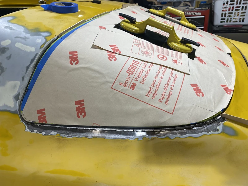

Ever since Year One released the first pics and videos of their Bandit Trans Am I knew I had to have Flush glass on my car.   I had no idea how difficult it would be.  Fesler makes a set of front and back glass that are supposed to fit flush in the stock location so you can delete the window moldings for a more modern look.  The front glass fit with no issues at all.   The back glass on the other hand was not so easy.   I had to build the car around the glass.
First fit check.   It didnt look good - 1980 Pontiac Firebird/Trans Am/GTA/Formula

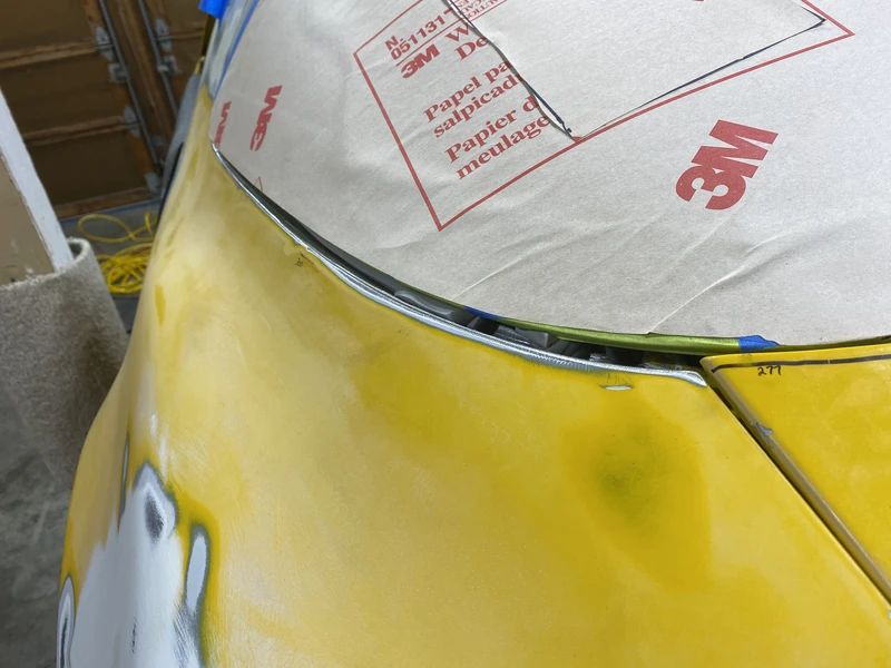

1/2 gap on the left side that needed filled - 1980 Pontiac Firebird/Trans Am/GTA/Formula

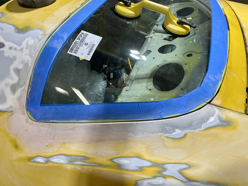

Metal work done - 1980 Pontiac Firebird/Trans Am/GTA/Formula
Metal work done

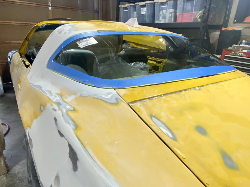

Roughed in bodywork  - 1980 Pontiac Firebird/Trans Am/GTA/Formula
Roughed in bodywork
Not bad for a rookie  - 1980 Pontiac Firebird/Trans Am/GTA/Formula

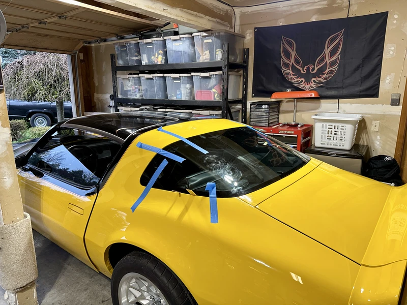

Installed.   - 1980 Pontiac Firebird/Trans Am/GTA/Formula
Installed.
