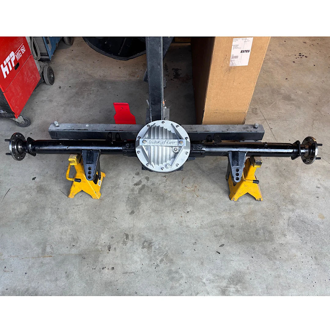

I have started the installation of the Helix 4 link. This is a universal kit and required a lot of modifications to the brackets and control arms to fit properly. The upper coil over mount is a custom fabricated piece and I will add the upper brackets once I receive the shocks. At this point the rear housing can be painted and assembled, but will not be installed for several months, if not years while I work on the rest of the car.
Helix universal 4 link kit - 1970 Chevrolet Camaro
Upper and lower control arm brackets tacked up  - 1970 Chevrolet Camaro
Fabricating an upper coil-over mount - 1970 Chevrolet Camaro
Coil-over bar mocked in place  - 1970 Chevrolet Camaro
Sketchy differential jack mounted to  rotisserie  - 1970 Chevrolet Camaro
Setting ride height  - 1970 Chevrolet Camaro
Setting ride height
 Verifying measurements and clearances  - 1970 Chevrolet Camaro
Fits great. Differential needs paint and assembly  - 1970 Chevrolet Camaro
Axle assembly is complete with Detroit TruTrac and - 1970 Chevrolet Camaro
