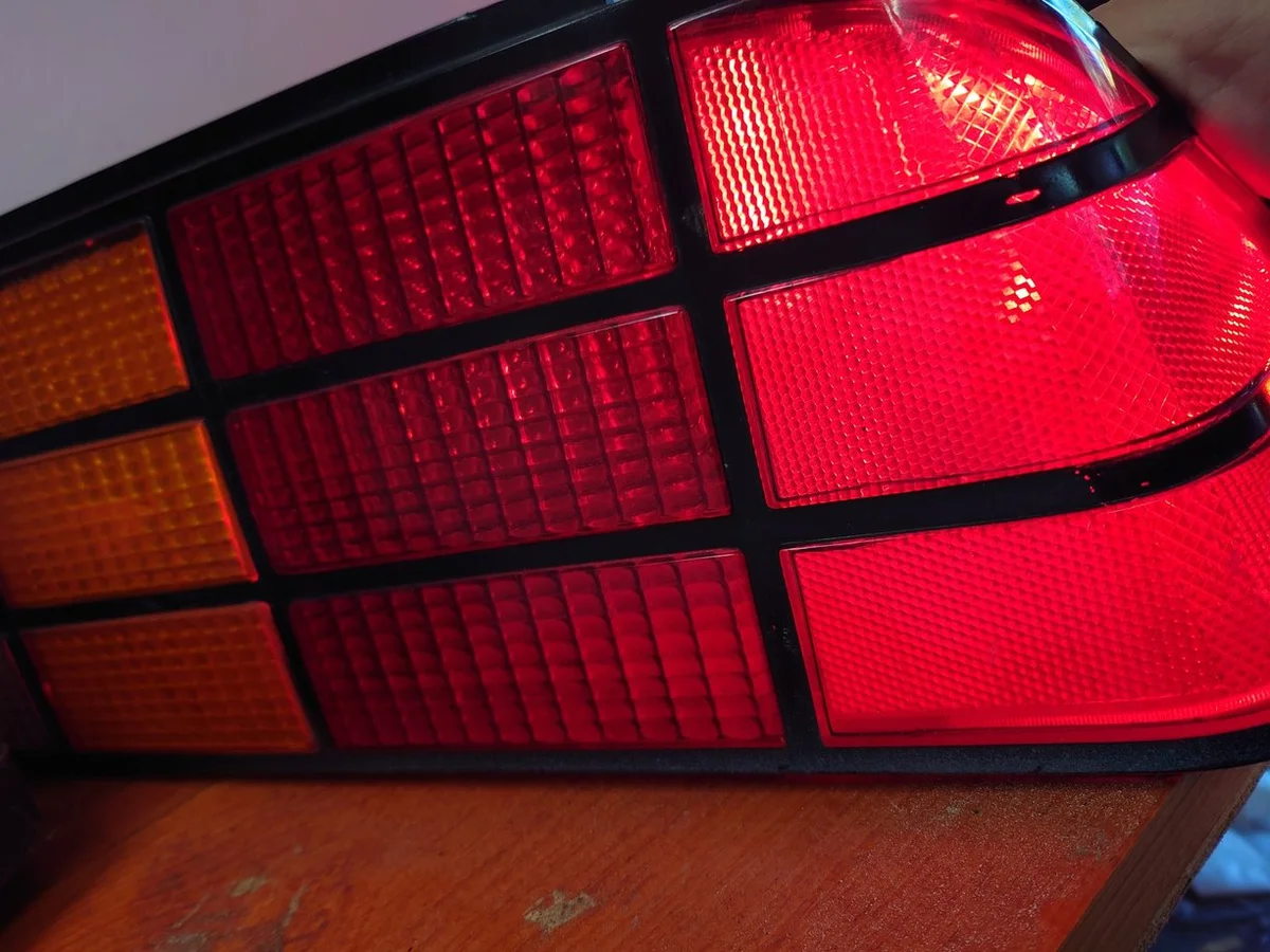

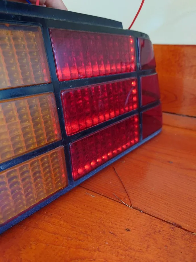

Today I worked on the reverse lights and the side marker.
Reverse lights

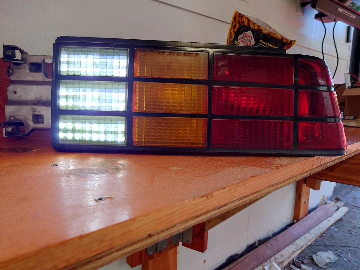

For the reverse lights nothing fancy,  just some superflux cree white LEDs.  2 rows per section.   These ones I'm recessing back into the housing a little, give it a little bit better glow.  These don't need to be as bright as the tail lights.
Market Lights

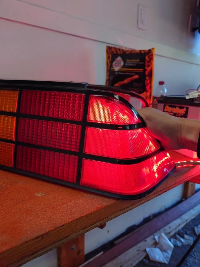

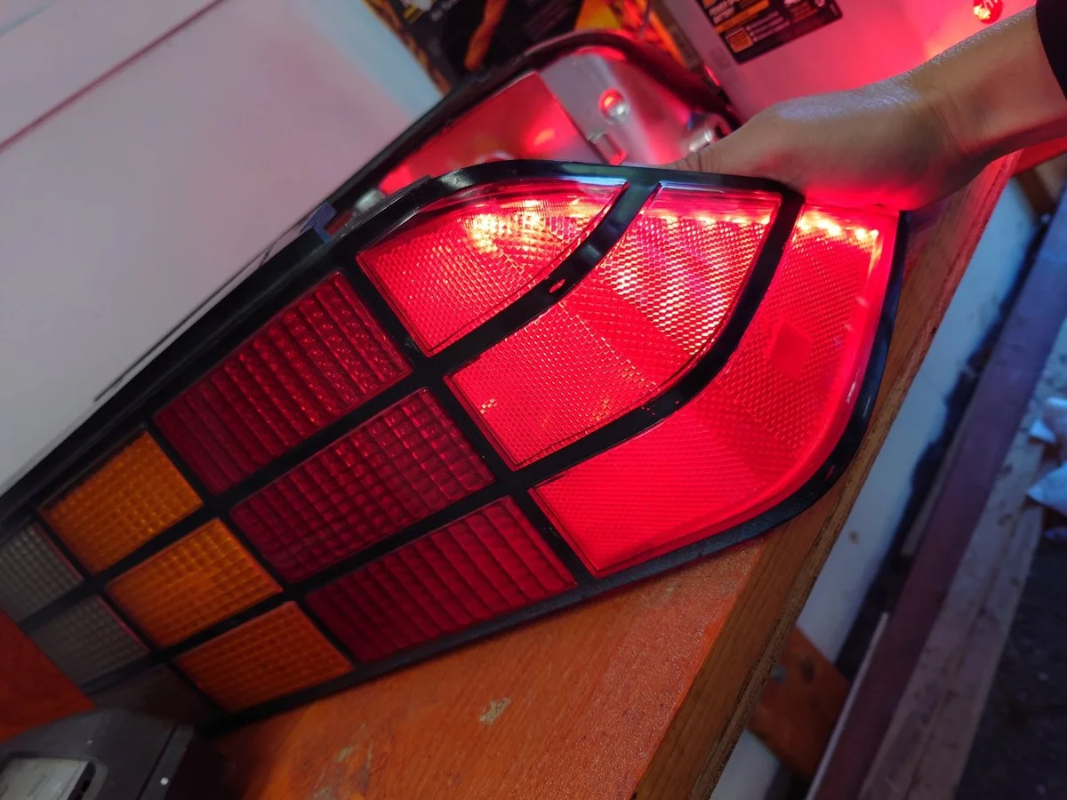

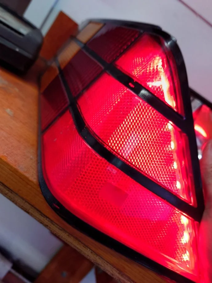

For the wrap around section,  I remember from last time that space was an issue here.  So this time, I decided to try some automotive LED strips.  My plan is to run one strip along the top of the section that illuminates down.  I think this might work, as it looks pretty good in this test.  Has a pretty even light, the only thing I need to thing about is, how to hide the wire.  The socket enter the light almost dead center.  That kind of sucks,  I would like to hide that.  Going to have to think about this some.
Next Steps:
LED wise, this side is done.  Next I'll need to start the wet sanding and buffing of the lens to make them glossy again and then repaint the grids.
1984 Chevrolet Camaro - Taillight restoration and LED conversion - Part 4 - Image 1
one strip of LEDs along the top - 1984 Chevrolet Camaro
1984 Chevrolet Camaro - Taillight restoration and LED conversion - Part 4 - Image 3

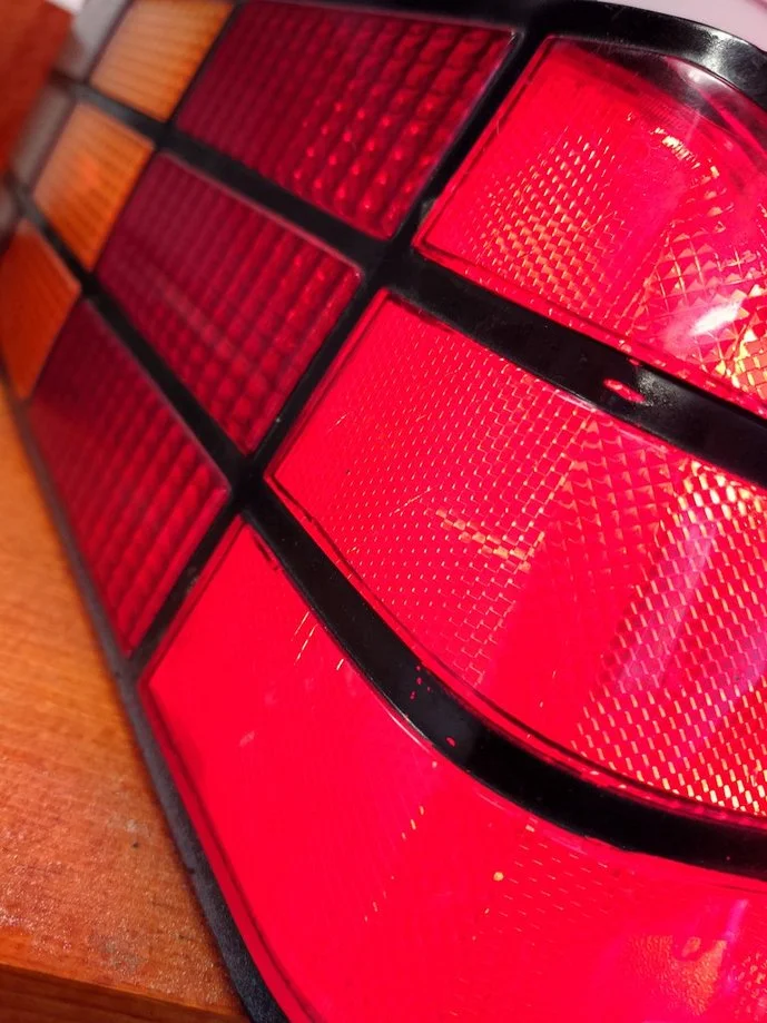

1984 Chevrolet Camaro - Taillight restoration and LED conversion - Part 4 - Image 4

need to fix that very last row - 1984 Chevrolet Camaro
