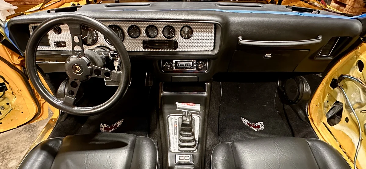

This is the before pic - 1980 Pontiac Firebird/Trans Am/GTA/Formula

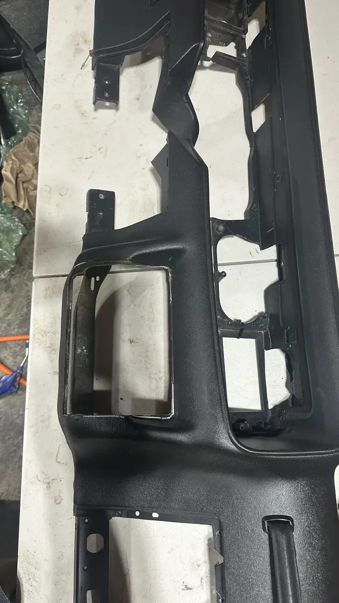

Whats getting cut out - 1980 Pontiac Firebird/Trans Am/GTA/Formula

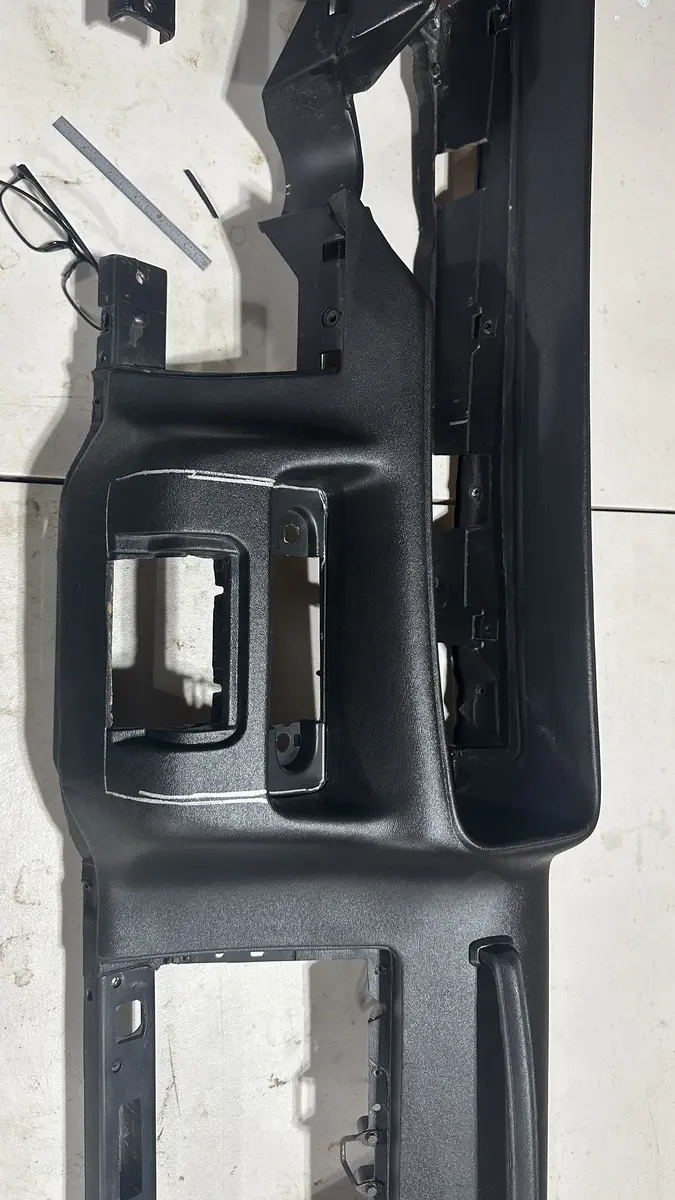

Im committed now.   - 1980 Pontiac Firebird/Trans Am/GTA/Formula
Im committed now.

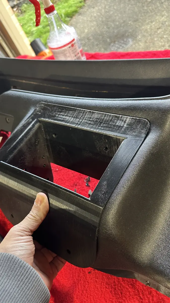

3D printed part to fit a double din head unit - 1980 Pontiac Firebird/Trans Am/GTA/Formula
Initial fit up  - 1980 Pontiac Firebird/Trans Am/GTA/Formula
Initial fit up

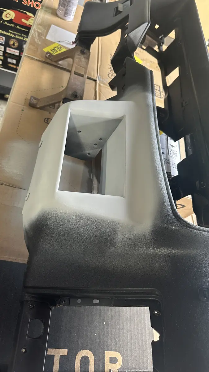

High build primer for any imperfections  - 1980 Pontiac Firebird/Trans Am/GTA/Formula

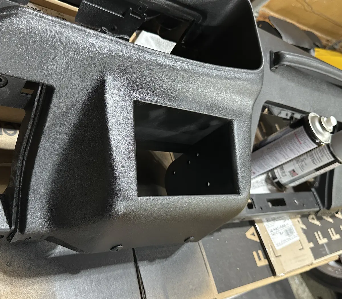

Texture is a little off but I think itll work.  Ov - 1980 Pontiac Firebird/Trans Am/GTA/Formula
