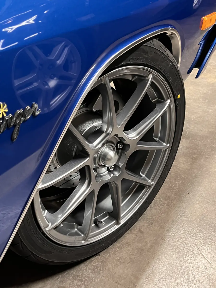

I started off with some rollers off a 98 Mustang Cobra. Those are 8” wide with a 30mm offset and 245 tire. While they worked nearly perfectly up front, they tended to rub slightly up front and rubbed out back during turns. I went with a 8” wheel and 35mm offset up front. I did have to have the wheel center machined and opened up slightly to fit the disc brake hub, then had to come up with a center cap to fit. I found some aluminum wheel caps that I polished that seemed to fit the look.

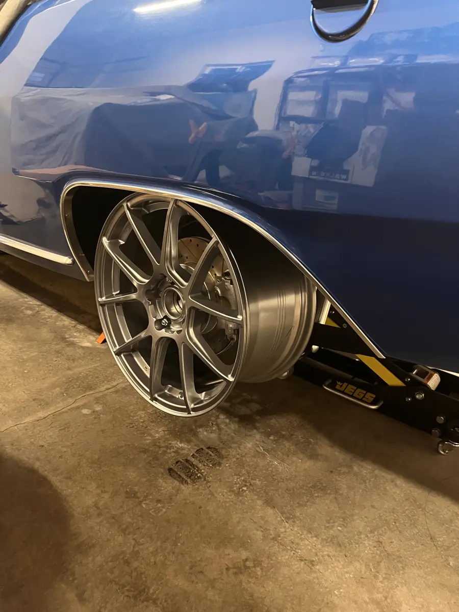

For the back, having moved in the rear springs, but not the wheel tubs, I had a little more depth in the wheel well out back. I ended up with a 8-½” wide wheel out back with a 45mm offset, with a 255 wide tire.

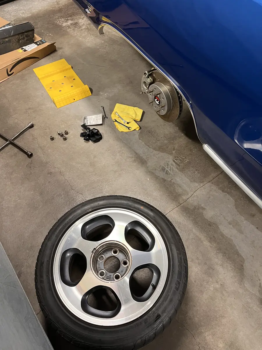

Fitting the rollers to verify size - 1973 Dodge Dart

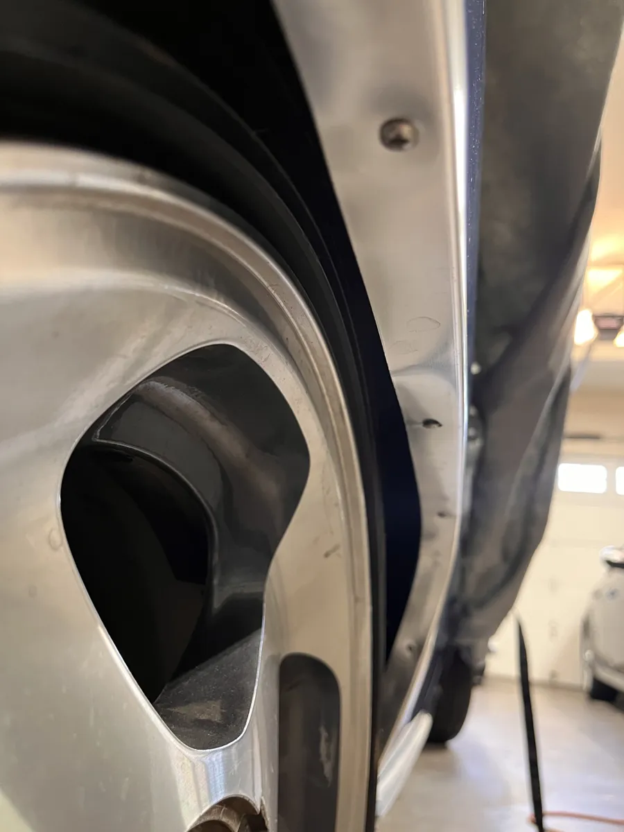

Back wheel was far too tight out back with the B-B - 1973 Dodge Dart

Good room out back - 1973 Dodge Dart
Good room out back
Fronts turn and dont hit the fender - 1973 Dodge Dart
