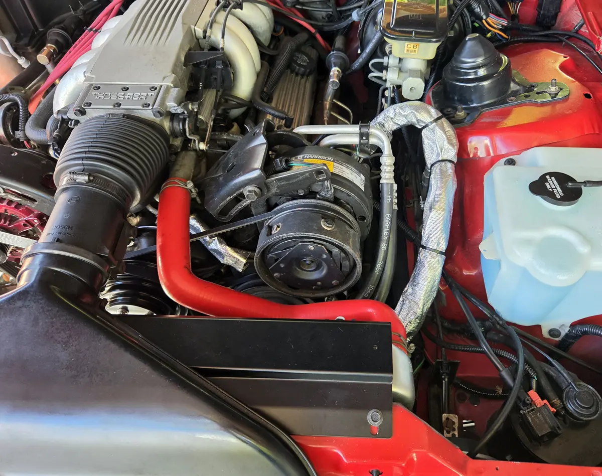

Fuel Line Heat Shielding
Starting from where the hard lines enter/exit the fuel rail, extending around the block and corner of the exhaust header, and then all the way to the fuel cooler (and back), I wrapped the fuel lines with DEI Heat Shroud Sleeving. I used both 2.5" and 1.5" sleeving to accomplish covering it all really well.
Summary
After an initial test drive, it was apparent that the fuel heating issue is much better!
