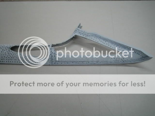

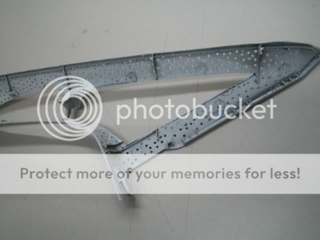

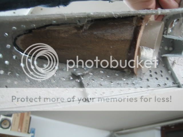

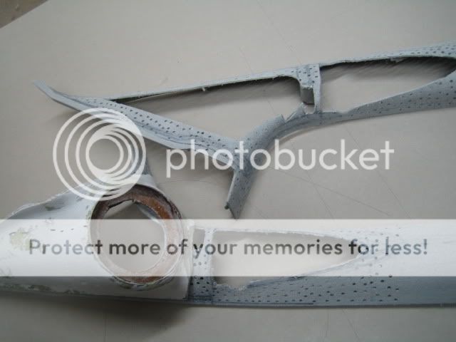

    original a-pillars are ready for joining with mid pod. Bunch of holes were drilled in original pillar for better bond between ABS and Fiberglass. A few spots were cut off of original pillar to accomodate Tweeter.
    Ford Focus A-pillars mid+ tw by LBaudio

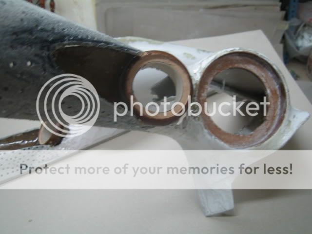

    MDF ring for tweeter positioned. Template was again made out of cardboard and secured to the pillar with hot glue and then resine was applied to the whole "thing"
