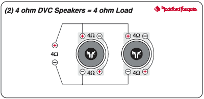

All i can say to all of your above posts is WOW.. I understand that you are new to this hobby but come on use a little common sense. Use the diagrams, and the infromation we have posted to set up your amp/subs the right way. Stop trying to hook them up your way because your "Blowing your transistor?" :argh . It really isn't as hard as you are making it. Just take your time, check back here as your doing it, and wire the subs up. Describe what you have done, and how you attempted to wire them, and if we all say it sounds good, the go ahead and give the amp power.
Have a good one
-David
Edit: If for some reason you haven't looked at the link that JeremyC has posted for what ever reason here is the diagram he's trying to show you (Attached image )
Here is another image i drew up quick: (Click To ENLARGE)

First thing i know about boss is that yea they suck, and ill admit, it was my first amp, untill i got smart... well smarter lol hehe anyway that particular model will run 2 ohms at 2 channels 800w each, obviously overstated... What u will need to do is wire both of your subs, u said they are Dual 4 ohm in a Parallel u can find this diagram at this adress just incase ur unsure:
http://mobile.jlaudio.com/support_pages.php?page_id=161
Make sure u are using at least 4 guage wire... at least 40amp fuses... and make sure that ur ground is clean and your power wire is not frayed or touching anything that could ground out... Also turn the Level on that amp down to like 1/4 and gain down to about the same... if it still smokes out its ur subs because that is the best and only way with those subs that will make them play...

thanks for the info the subs r wired up in the way u said to but even with a set of punch 10's hooked to it transistor still blows must b a problem some where else on the board.thanks for all ur input if i have any future problems i'll be back.
