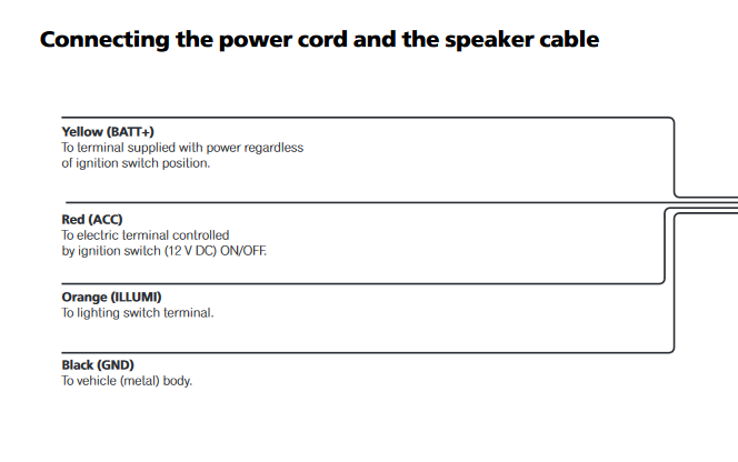

I found this:
The attachment app3.PNG is no longer available
What do you have the yellow wire hooked too?

Chris from Washington wrote:I found this:[ATTACH=CONFIG]2072[/ATTACH]
coming from the deck? all those wires are color matched with the harness /interface chime box

RESOLVED... Turns out that these stereo/dvd players with the 6"-7" screens can be a pain in the ass to wire up right if your going to use the back up camera and using the "proper installation" instructions which tells you to hook up a certain wire to your parking brake switch that only allows you to use the stereo while you are in park and the emergency brake is in place which is dumber than hell but it's for safety reasons. If you want to bypass that simply tied in with black wire coming from the head period then at least it will work all the time. Here's the golden shit. You have your yellow wire for constant power red wire for turn on with your key. What I did was tied the red wire from the deck to my fuse panel and tied it into the ignition slot with a fuse and it all works again! I will post some pictures when I get some time
