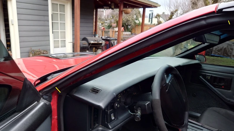

When I was restoring this car, I hit a snag trying to find a proper replacement the rubber seal connecting to the A-pillar trim. It's supposed to fill the gap between the car and the trim, but it always bothered me how you could see the paint underneath.
After doing some digging, I stumbled upon a solution: the ESI Ultimate Tailgate Seal Large. It fit just right and gave off that genuine OEM look once installed.
I have to admit, I'm pretty thrilled with how everything turned out. It's another box checked off on this restoration.
Passenger side, after installing.  - 1984 Chevrolet Camaro
After installing, gap is filled. - 1984 Chevrolet Camaro
Before applying the seal, large gap - 1984 Chevrolet Camaro
