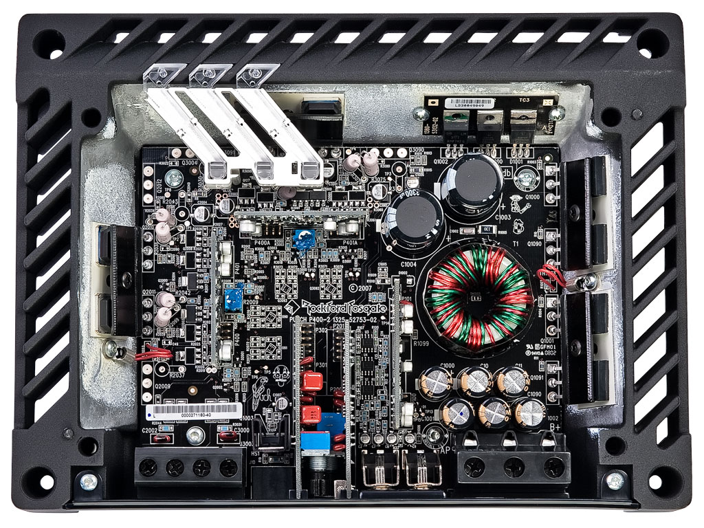

The sony has a 30 amp fuse, and I can't see any fuse on the RF p500-2... From what I understand, it has great protection? Perhaps it doesn't need one? Or it may be internal, I don't know...
I think this a pic of it's guts. I would love to take mine apart and see for my self but I'm not sure how.
