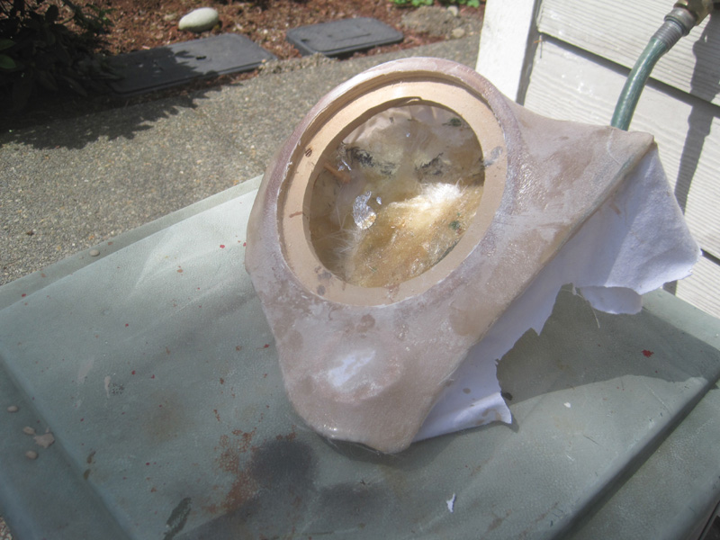

Once dry, you can apply another layer of mat to your mold for strength. Let dry again.Image
Mount Speaker Rings
Now, take your speaker rings and place them in the mold to get an idea of how it will fit. Now you’ll use the dowels and the glue gun. I drilled some holes in my speaker ring and slid the dowels through to allow me to adjust them. Once they are set (make sure your speaker has clearance). Hot glue them to secure them and lock them in place.
NOTE: When aiming the speakers, try and aim toward the review mirror, or dome light. The woofer is not as important as the tweeter.
Apply the covering
Now remove them from the car, and you can cut away the extra mat you didn’t put resin on.
Grab that old T-Shirt and stretch it over the mold and speaker ring, try and get it as wrinkle free as possible. For me, I have spots that are not seen once installed, so if I had to have wrinkles I had them back there. Secure the T-Shirt with the hot glue, trim off any extra.
Once you have the shirt in place, you’re ready to apply the resin to the shirt. With the shirt you’re able to brush the resin. Allow to dry.
NOTE: Do not apply resin to the inside of the speaker holes. You are just going to cut this out anyways.
You will need to strengthen the shirt portion, what I did was apply mat to the ‘INSIDE’ of the mold. This will save you from extra sanding later.
Once dry, do a test fit in the car. Just to make sure nothing got tweaked when applying the fiberglass.

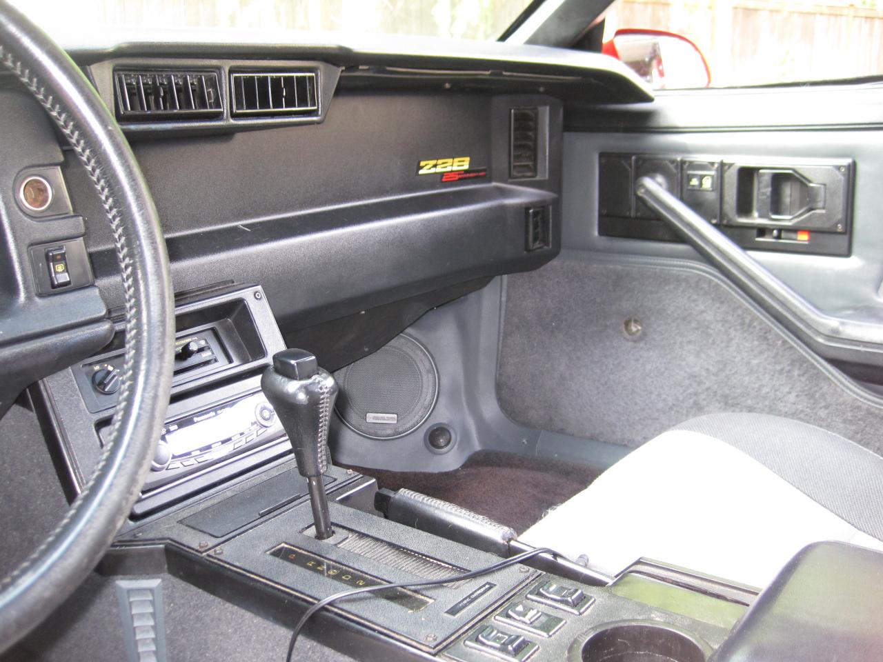

Some people like to cover their pods with carpet or vinyl, depending on the car you could do this. But with mine, it just doesn’t look right. So instead, I choose to texture my pod using the SEM texture paint, then paint over that with SEM color coat (this is the paint on the rest of my interior pieces) so that it will look almost identical to the factory plastics.
Done!
All Done
